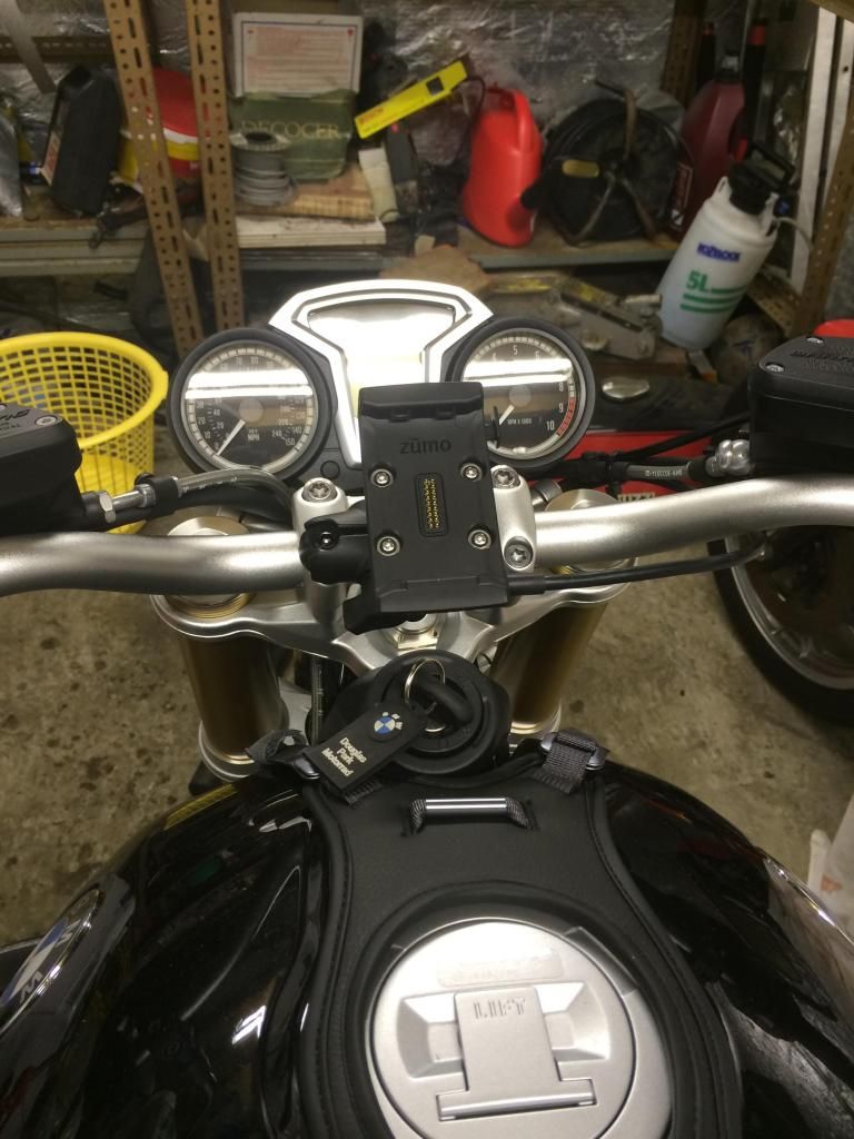

Next up was fitting the BMW tank bag harness... Very easy and the harness looks good enough to leave on the bike without the bag. Added bonus is that the harness will help protect the tank and save me buying a tank protector.

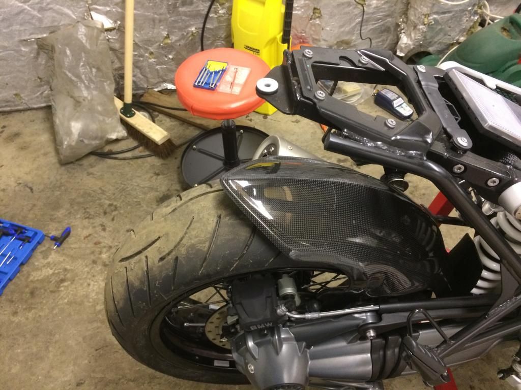

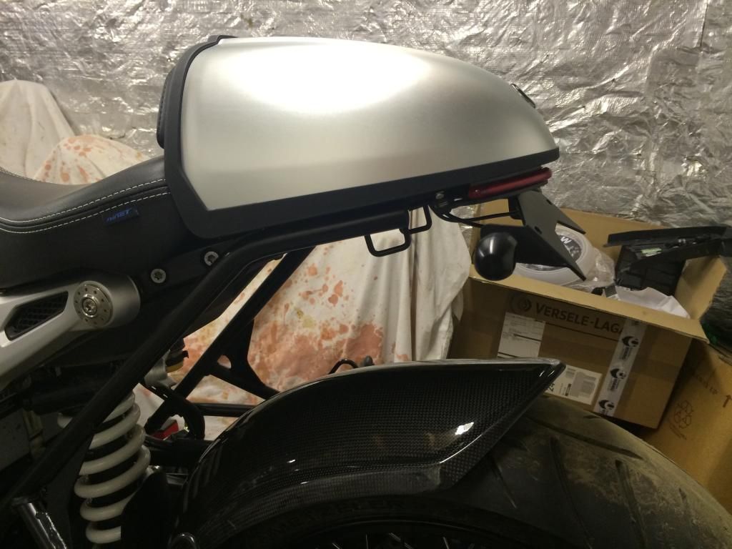

Now for the expensive part! Ilmberger carbon fiber Hugger! ;)
An easy enough install once the silencer and rear wheel is removed, but I was uneasy with simply using the bolts provided with the Hugger as the bolts that came off the rear bevel drive had large captive washers on them, so I used some that I had in the garage. Took it nice and steady torqueing up the bolts to the required value given by Ilmberger, and there were a few creaks of complaint from the hugger as I neared full tightness. Sweaty palms time! lol
MMMMMMMMMMMM.....Carbon fiber goodness!

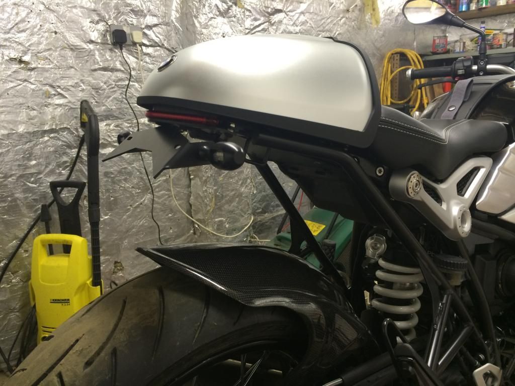

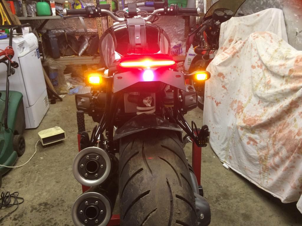

Very happy with how the bike looks so far.... Now waiting for the Motobox LED tail tidy before ditching the exhaust flapper valve and bolting the rear wheel and silencer back on.
Oh and I managed to find a use for that ugly diving board at the back of the bike before the tail tidy arrives.... ;)

Hey Dave, What's in the mug? Bike looks great. A word of advice on the tank strap...Cut out a piece of microfibre cloth the same contour as the front part of the strap(Where it is closest to the key) and keep it under the strap when you tighten it all up. That is the one area where I have seen accelerated wear under the strap.
I have seen wear from tank bags on too many bikes. Due the "soft" nature of this tank's paint, I went with the Hepco and Becker tank bag that mounts to the fuel filler and does not touch the tank at all. I highly recommend that route.

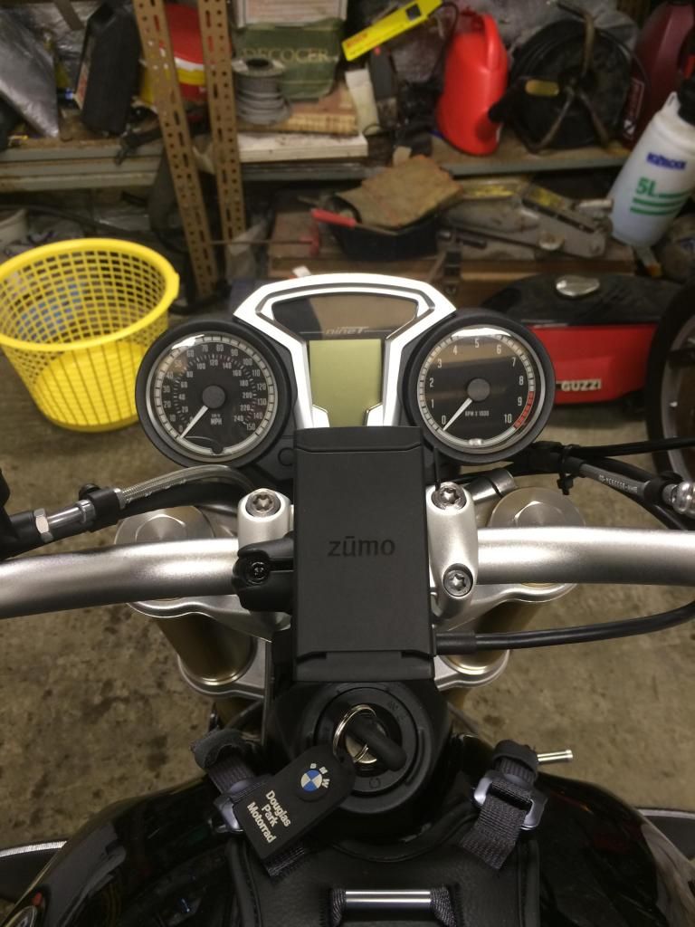

My girlfriend gave me a mug upgrade as part of my Christmas present! :)
Here it is installed on the bike.... ;)

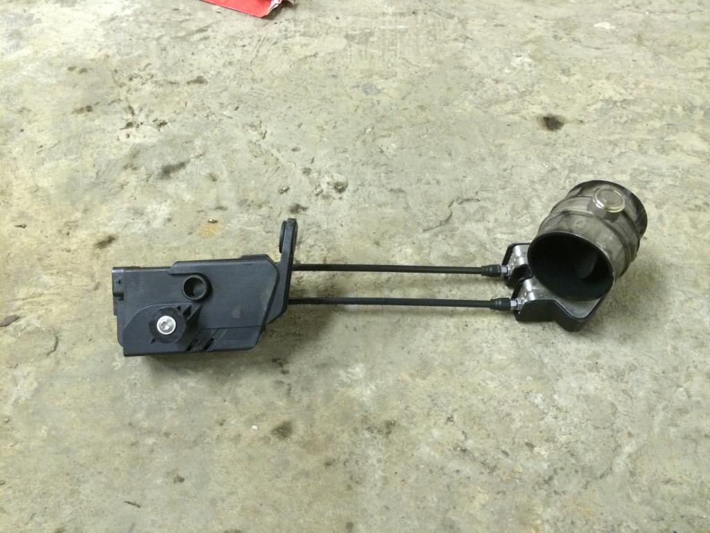

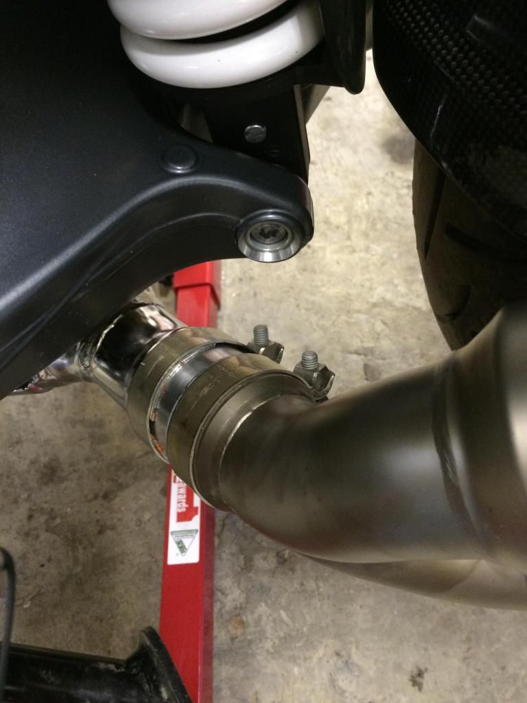

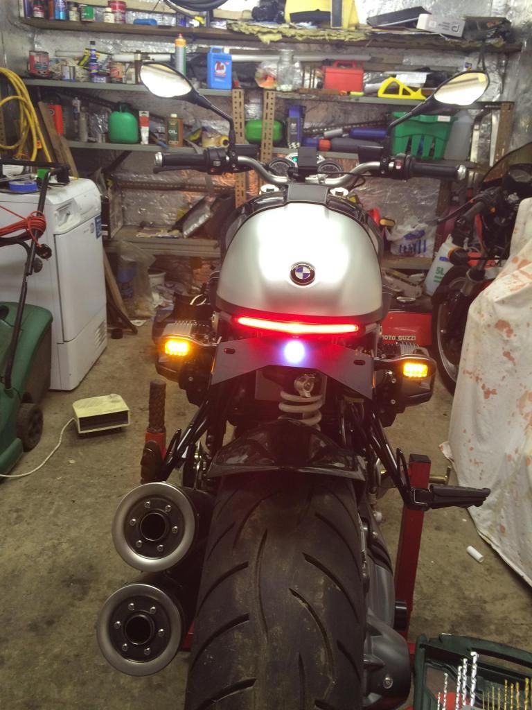

Exhust system "flapperectomy" in progress.... ;)

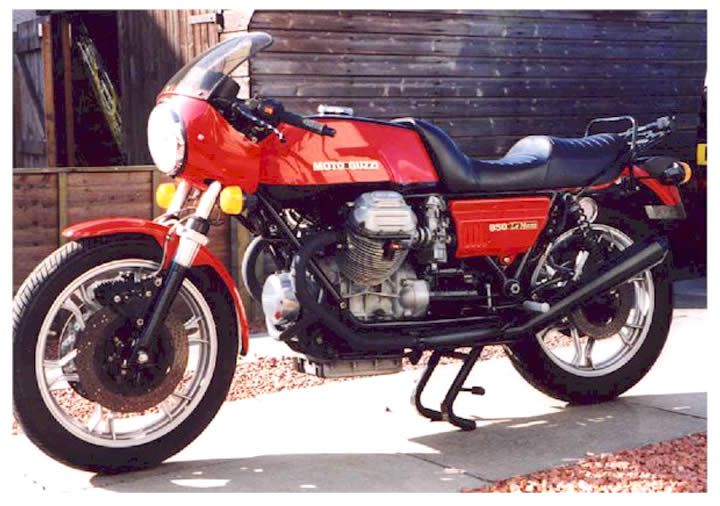

Can we see the other bike in the background?
My Le Mans is getting worked on at present so is in a state of undress! lol
Here's a picture of her with her clothes on.... ;)

I just quickly started my bike to hear the effect of the flapperectomy. WOWWWWW!!! So much nicer. Got a noticeably louder and deeper sound at low revs with more of a hard edge to it. I can only imagine what it's going to sound like on the road...... :D

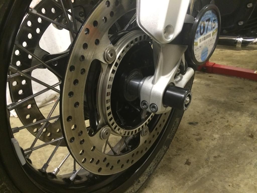

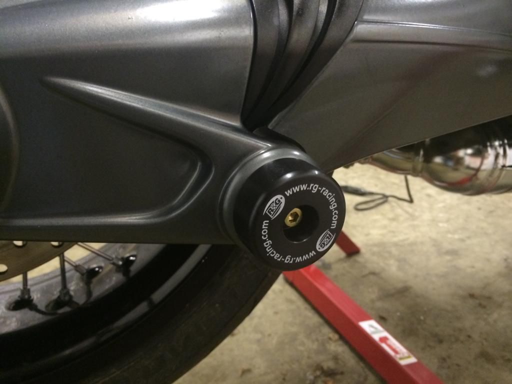

I got R&G Shaft Protector and Fork protectors which were dead easy to fit, and along with the cam cover protectors will help prevent damage in low speed tumbles.
Literally took 15minutes work in the garage and all was done!

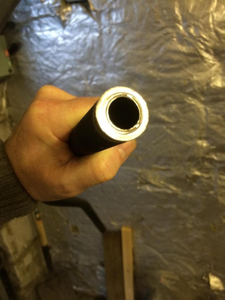

First the shaft protector - 5 mins to fit....
Lastly the fork protector, 10 mins work to get it sitting exactly right....
There is an identical "crash bobbin" on the other side of the wheel.

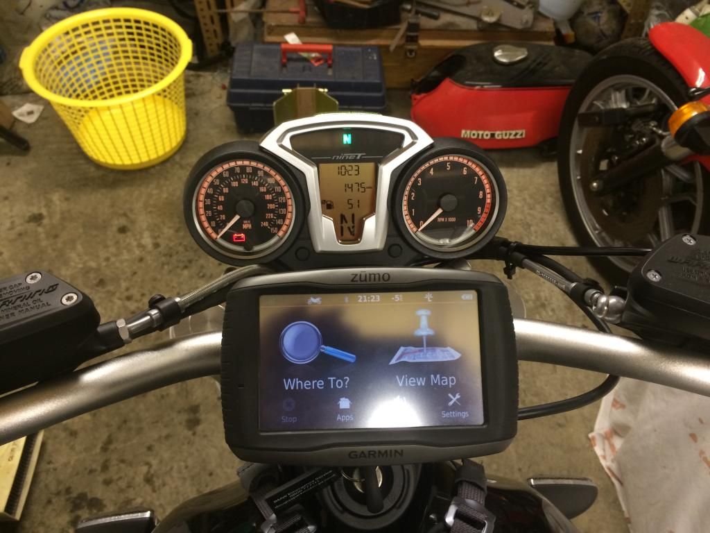

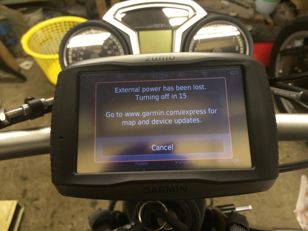

I also started work on fitting my Garmin Sat Nav to the bike by installing a RAM mount on the handlebar clamp. Not posting a pic of this as it's boring and the job is not completed.... ;)
