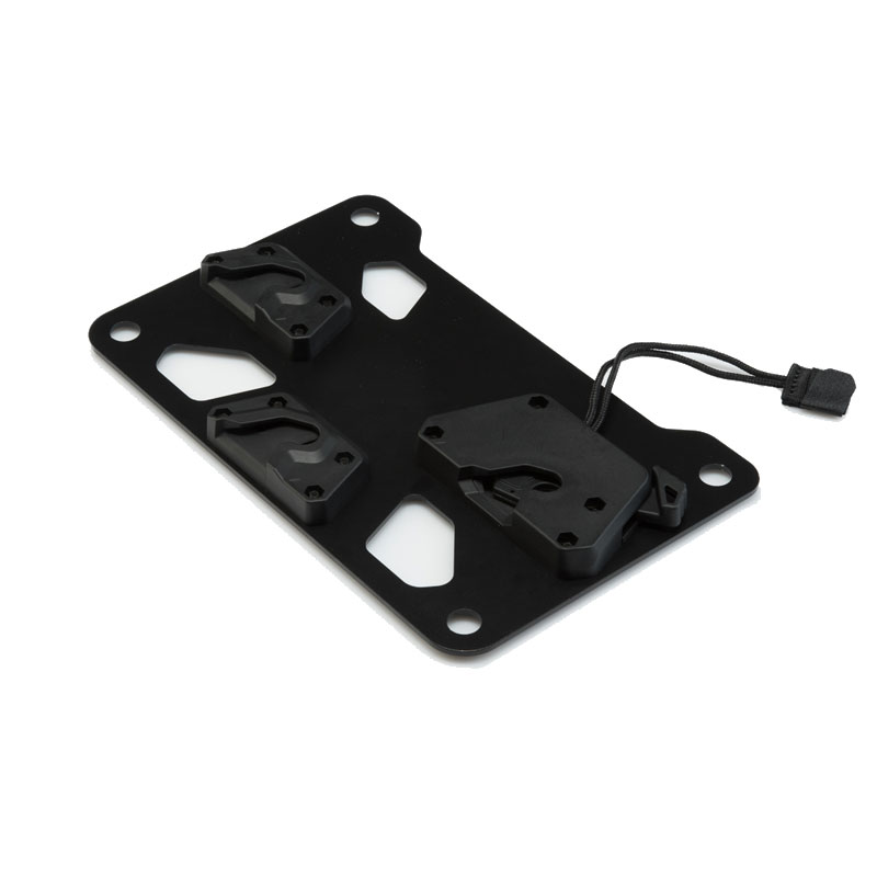

If you plan on going this route, look at the SW motech Universal holder. Universal Seitenaufnahme für SLC Seitenträger rechts
I think this is your best bet in attaching the cases in a sturdy way. You could also look at a sysbag adapter plate.
They would have to sit higher to clear the exhaust though on the left side. So a bit higher / even with the rear hump.
  • Looking at the 30mm (i think u mean mm?) clearance for the exhaust; this should be fine. Bags have about the same clearance. If you are worried you could always add some heat shielding to the bottom of the pannier for extra protection.

And sysbag 10L plate adapter is my final choice. I have legends sw motech SLC but I want bigger bags. SW motech are warning about not overload more than 5kg each bag...so bigger heavy panniers not able to load so much luggage is not worthy
