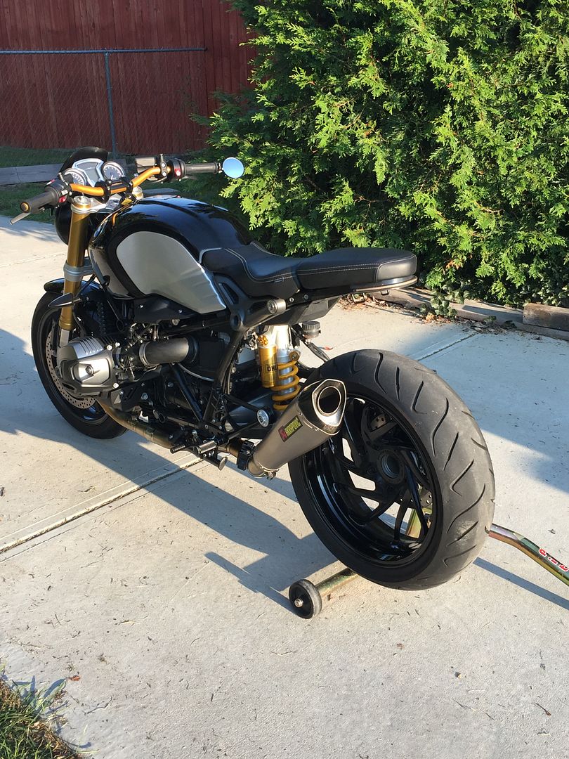

Hey gang, haven't posted an a bit, but we're wrapping up a build and just wanted to share we have our first numbers on our RnienT road racer at 110.1 rwhp on pump (93) and second and third T being tuned to VP MR12 and hopefully 118'ish.
Livengood Motorsports in Lawrenceville, Ga was successful in also getting Dynojet's shift assist on my T's for fun Clutchless throttle on up shifts!
Decent build going on and geometry/spring rates are being tested. Cylinder head clearance an issue.

Awesome--really interested in hearing more about the shift assist and how they managed to do this.
