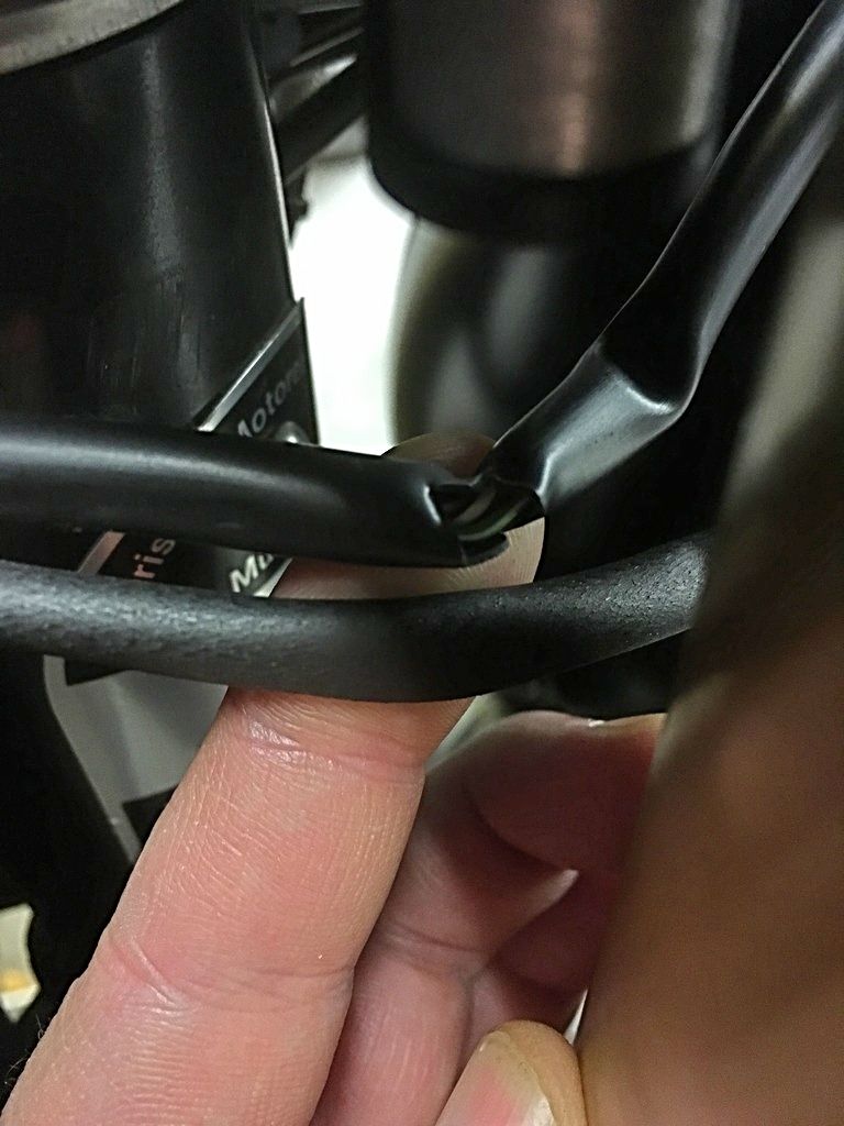

Here is what I found when I inspected my bike:
The wires inside the sheath appear undamaged, if they had been I wouldn't have progressed any further and would have contacted the dealer and try to get a good-will warranty repair done as this should never happen to a bike this new with under 3000 miles on the clock. As it was there was nothing to lose by continuing.

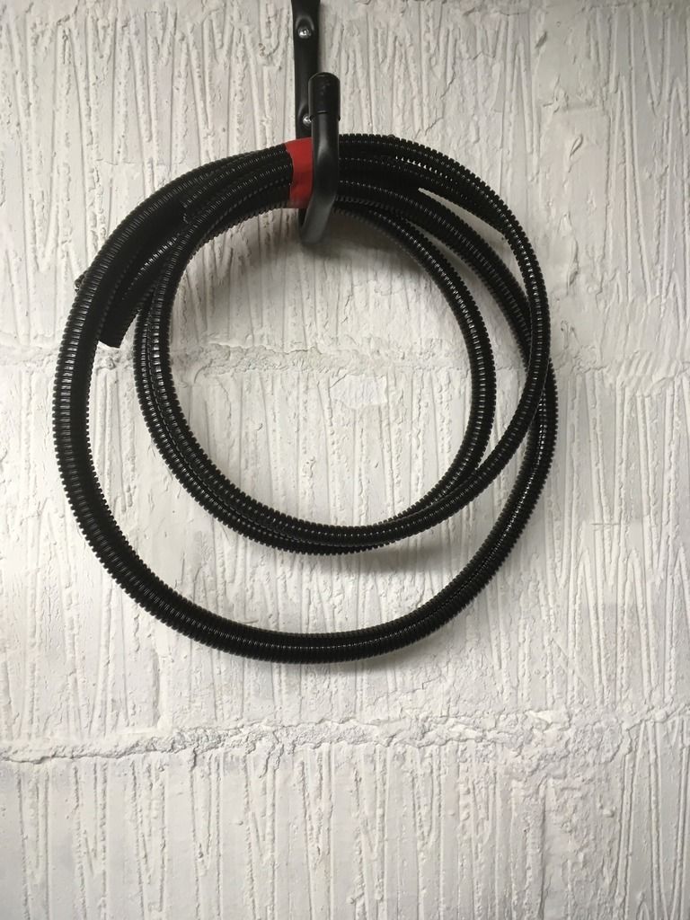

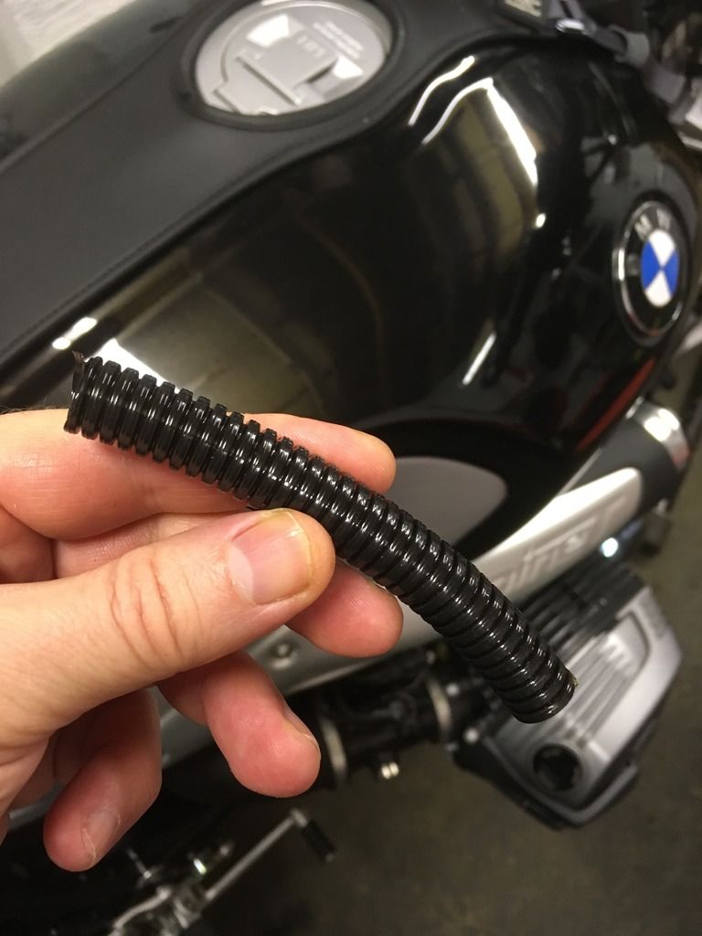

I bought a bunch of 1m long pieces of flexible conduit (with the split running down the length) for less than £5 delivered...

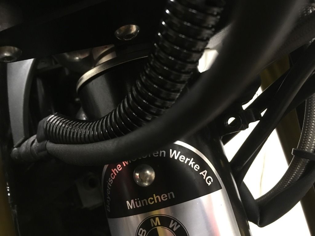

Cut a piece to size and installed it on the bike. I left the damaged sheathing on the bike and the new conduit just slipped on over the top of it. A nice tight fit and I can't see this new conduit coming off easily.

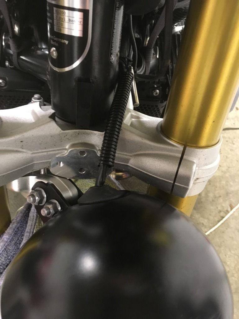

I found it easier to unbolt the headlight (2 bolts, under a minute to do) and rest it on the front mudguard. This gave me lots of room for the install.
I noticed that the headlight loom had the same stock sheathing on it as the instrument cluster, and sure enough when I inspected it, the sheath had crimped and I reckon wasn't long from failing too! Not good! Anyway since I'd stacks of flexible conduit, I fixed that too. :)
