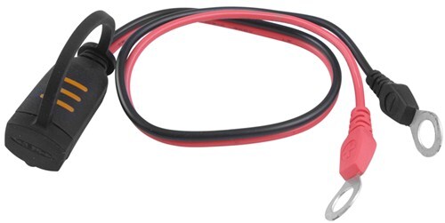

You should only need to remove the seat to install those pigtails.
You can attach the charger connector to a frame rail for easy access. I just tuck mine in the gap alongside the battery.

Most people buy a charger that comes with a SAE type plug kit which you wire direct to the battery and lead the socket end hanging somewhere convenient. (Pic of mine here).
