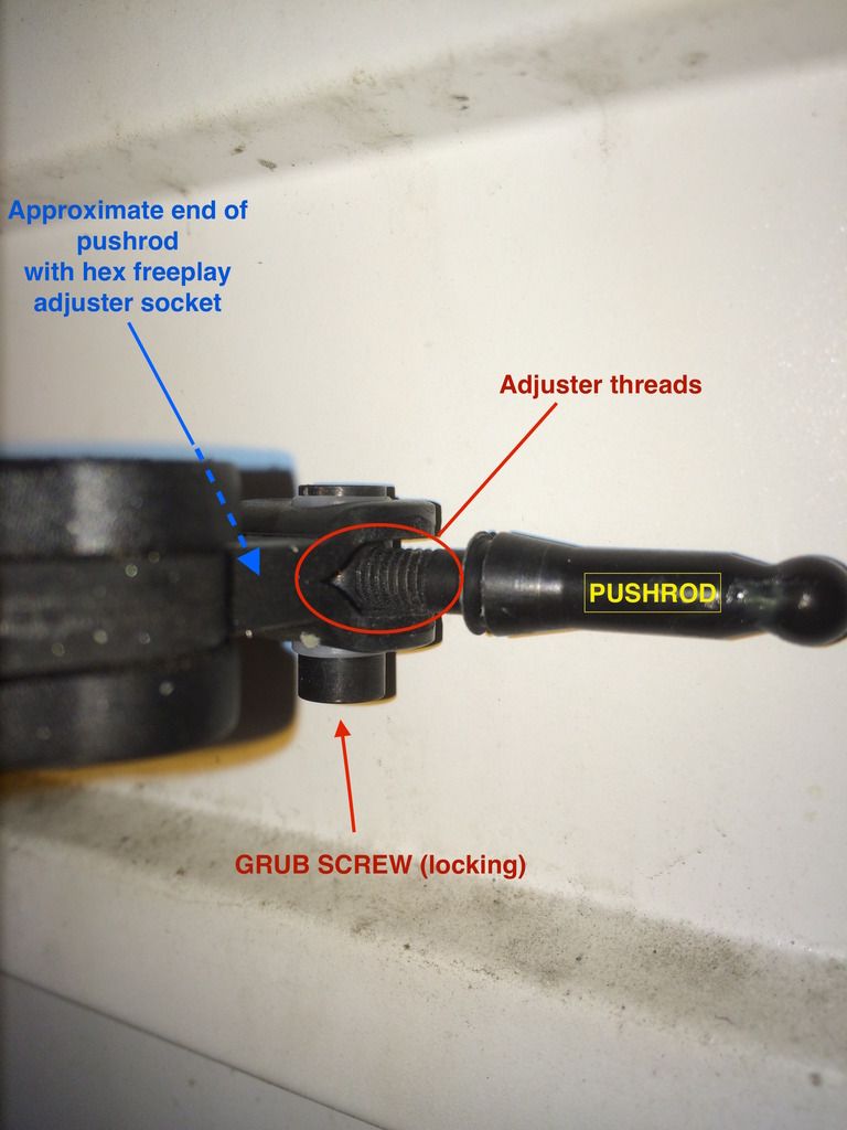

Dear Dave Sorry to be thick can you try and help me Im looking at the red dot on the bottom and the hex grub that goes into the side how do I get the red paint off /glue is the only bit that needs to be un screwed the grub going into the side sorry mate I cant get my head around any of this cheers Marco

Hey Marco. Mate if you are unsure of the process, do you really want to adjust something that can have very serious safety implications if you get it wrong?
I'll try to clarify....
Carefully use Acetone to dissolve the red thread lock on the grub screw. The thread lock is not just on the end of the screw, but on the grub screw threads too. The acetone should penetrate the threads and help release the screw. This small grub screw locks the freeplay adjuster pushrod in place to stop it moving (potentially disastrous). The pushrod itself controls the freeplay of the levers.
Perhaps this diagram will make things clearer?
The pushrod is also known in this thread as "threaded goody". The hex socket referred to in my diagram is a hex shaped "hole" in the end of the pushrod.
Please take time to carefully re-read the thread and hopefully with the aid of the above diagram things will become clear.
IF YOU ARE ANY WAY UNSURE OF THE ADJUSTMENT PROCESS, OR NOT CONFIDENT OF DOING THE WORK CORRECTLY, STOP!!!
IT IS NOT WORTH RISKING EITHER YOUR OWN SAFETY, OR THE SAFETY OF OTHERS FOR AN HOURS LABOUR CHARGE.
Things can go DISASTROUSLY wrong if you adjust the brake free play incorrectly, or fail to put thread lock back on the locking grub screw after the adjustment is complete.

Dear Dave thanks so much I have managed to get the thread lock off so all ok when putting thread lock back on at the end I have some in a lip stick type tube 222 it's a blue colour is this OK or do I need to use a liquid red one I normally use the 222 on most bits on the bike ?? Cheers old boy Marco
Can't comment on the lipstick tube thread lock you have, to be honest I've never heard of that type.
I'm pretty sure BMW would only recommend you replace the thread lock with the high strength red stuff. That been said I made a personal judgement call and used medium strength blue liquid thread lock on the locking grub screw on my bike.
Your call on what you use on your bike, mate. :)
