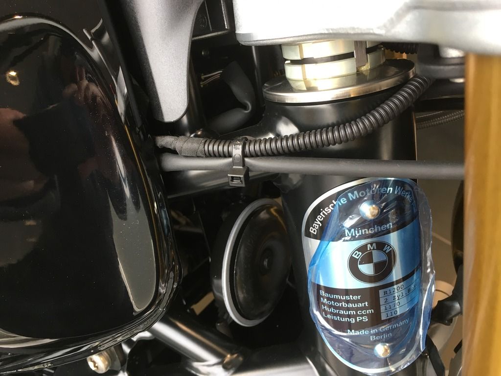

Had a conversation with my local motorrad dealer re this issue, unfortunately the ICE system was down (which has all the service issues and recalls for all BMW motorcycles) but I was told that they were aware of the issue, and one 9T to his knowledge has been in for this issue and the room was repaired using sticky cloth wiring tape. He isn't aware of any recall at this stage or any modified fix other than tape. I let them know what my fix was and to note that I had been in to report the issue on my bike, also made them aware that this forum has had several reports of the same issue plus showed him photos of the damage on my bike. They could see by looking at my leg brace and crutch that I was in no state to ride my bike in! lol
Anyway I did notice that later 9Ts have got a revised wiring loom with sleeving that looks very similar to my repair.
Below is a photo taken from a brand new 2017 R nineT.
The fact that BMW have altered the wiring loom design is pretty-much an admission that they got the original loom design wrong. Doubt that BMW will put it that way though! ;)

Is it me, or does that harness still seem stretched too much? They didn't lengthen the harness, but just added the protective loom. :icon_scratch:
Think you have a point there...
Makes a difference if you have stock bars or not. Lower farther forward bars and you have more slack.
Respectfully disagree, mate. The bars make no difference as the part of the loom that is failing goes to the instrument cluster. Irrespective to what bars you choose to put on your 9T, the instrument cluster stays in the same place.
